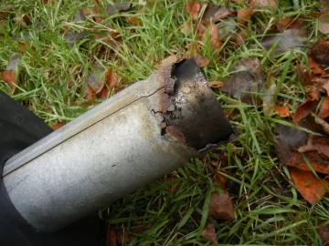

I have found the failure to be near the end of the venting outside where the exhaust cools and condenses eating holes in the pipes. I have posted some ugly pictures but not near main computer this afternoon. Enjoying the deck after its cleaning this AM and a strawberry daiquiri.
Outside and connected to the vent hood [Hearth.com] selkirk vent and corn

Yes, pin holes in it. They stop as soon as the pipe enters the thimble. The weather is a factor as we sit at well below zero for months and sometimes need to knock off the ice off the hood.

Also, the pic, i'm guessing that was a horizontal direct vent? Were the pin holes evenly distributed or were they at the bottom where the ash lay (still assuming horizontal).
The holes are primarily where the ash and condensate lay. I can't remember what the stainless was that I used as a sleeve. Got from Guy metals as a swap. Told them what I was trying to do.
If the corrosion is limited to the outside section of pipe and where the ash lay that help a great deal, mine is vertical and about 10" exposed out of the chimney, i may not worry or i'll add a few feet of single wall and let it take the corrosion, toss it when it's done and add another.
