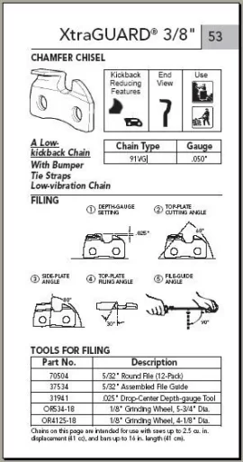

Thanks for the help. I will take it into a dealer, but in the meantime I found this page on Oregon's web site. All the 91s use a 5/32 and 30 degrees, so even if I can't be sure its a VG I know what to get.
(broken link removed)
It would be nice if they stamped the full model number somewhere on the chain.
