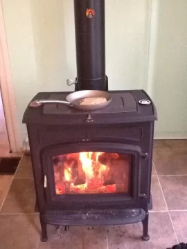

Corey this is how I have my gauges set up granted it is a different stove but should be the same idea. Mine are set up according to Jotul's recommendation you may want to see what Vogelzang recommends if you have not. They actually have good customer service by phone at least when we owned one.
Pete
Ps
Ignore my breakfast or else ;)

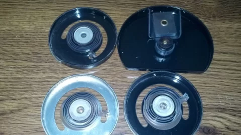

I bought a Tel-Tru magnetic thermo last year, one of the best things I did. Its enclosed, so even with the blower on, I still get a pretty accurate reading. I normally place it just it front of the flue, so its also blocked by most blower air.
I have a half dozen stove top thermo's. A couple Meeco's Red Devil, 2 different Condars, and one that just says Home Saver. They all only have 4 windings on the back of the unit. Where the Tel-Tru has 6 and has a flush plate that goes around the windings (also helps to keep the thermo reading with the blower on). It also has a "limit" needle. So when I return home/wake up, I know what my Max temp was while running. It was an added feature. Tel-Tru has lots of options and also have probe type thermo's.
It was pricey and I forget the Forum member who started the thread and had the link. Its the best reading thermo i own.

Dexter- is that Tel-Tru a model DM-014-750? I'm checking their web site and that number looks like what's at the bottom right of the magnet face.
Yes. 14-750. The DM stands for Dual Magnet, IIRC and the 750° is the Max temp. (It will go past 750°!!!)
