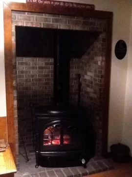

We run a Jotul Oslo in our 2000 sq ft cabin. Its our only source of heat and has done its job for a while now. That being said, this winter was colder than most in the NE and I found myself cruising through the wood stacks faster and waking up more often to stoke the fire and keep house temps up. Normally I'd load at night and then reload in the morning and the house would keep its warmth. This year its been a lot of putting extra wood in the stove and doing so more than normal to keep her hot. Im now looking to upgrade for more heat output and a little longer burn times. I think I'd go right for Jotul's Firelight or the T6 if Woodstock hadn't made their progress hybrid. Im pretty close to pulling the trigger on it after reading its great reviews and burn times. I just need to make sure there will be a big enough difference from the Oslo, which Im pretty certain there will be. Jotul is a great company and we love our stove, just scared to get another winter like this one.
Jotul Fireside with CAT and a cat.
