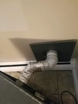

My question is about the vent piping I have. The stove is cornered and has a "s" shaped pipe leading out through the wall. The pipe extends straight out of the house for three feet and then there is the cap. There is no rise at all from the back of the stove. I've attached a photo of the pipe.
I am reading that most people have a rise above the level of the stove. Should I go to the store and add in a 90 degree and rise the pipe outside? I was going to add an OAK and figured that I should check in about the pipe while I'm at it.

If I simply reconfigure the pipe with a cleanout 90 degree and a 3' rise, I shouldn't have any issues with the stove right?
I finally got this thing running well and don't want to mess anything up.
Nope it should be fine. It may like the extra draft it will get ;)
