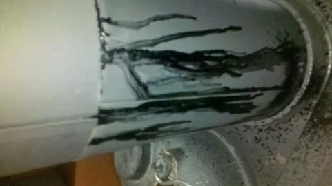

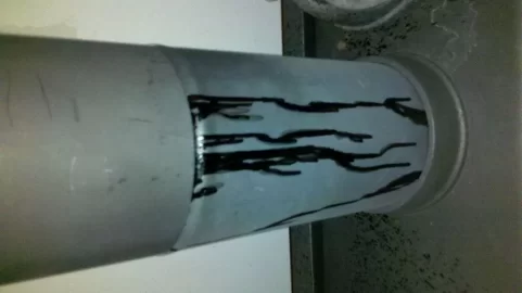

I came home to this on my stove pipe.
Should i be concerned?
This is my first time burning in the new stove while away at work when the temps stayed below freezing for over 24 hours.
Im kinda worried.

Yep. It is upside down. And that pic shows the precise reason that the crimps should point down.
Yep it sure is upside down. :)
Did you install it yourself, if so, no worries, many have done it before that way. Just correct it and viola, you should be all set. I would imagine you would want to spend some time on this site so you can learn a great deal to help you out. I would also suggest if this is your first year you may want to hire some help just this time so you can have the whole chimney setup the correct way and not take any risks. Most people do this and then over time you will be a pro ;-)

Do you have a thermometer on the stove or flue pipe? Besides the pipe being installed upside down, it looks like the stove may be running too cool.
That was after a 9 hour burn. The stove is a sierra 8000 tec cat stove
Durning burn times the stove top is 600-650
It was also cooler in that pic cause I had the blower running
Aside from the obvious, I'd also be concerned about wet wood. SInce you say you have a new liner in an existing chimney, I'm guessing this isn't a straight-up shot and that there is an elbow/thimble/tee in there somewhere. For that amount of moisture to drip back to the stove is alarming and reversing the pipe to hide it is like taking the battery out of the smoke detector.

Thanks for the pic. You can see that with the tee, it does not seem plausible for rain or moisture condensation from the chimney to find its way to the smoke pipe close to the stove. The moisture that dripped out likely came from the wood or from the air in the room (assuming no OAK).

Now that you mention it the few pieces that i did thow in were quite wet on the ends from the storm. My tarp got blown off.
Could that be the mosture from the wood before the fire got going real hot?
Let's hope that was the case. I remember years ago at my former home getting a late Fall wind and rain storm that shreaded my tarps and then it turned to freezing rain just before the big chill. My wood was covered in ice and I had to chisel off as much as I could before bringing it in with the shreads of blue tarp stuck to it. I was still picking up blue shreads years later and so too were the Robins to use in their nests.
