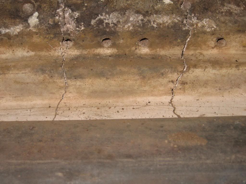

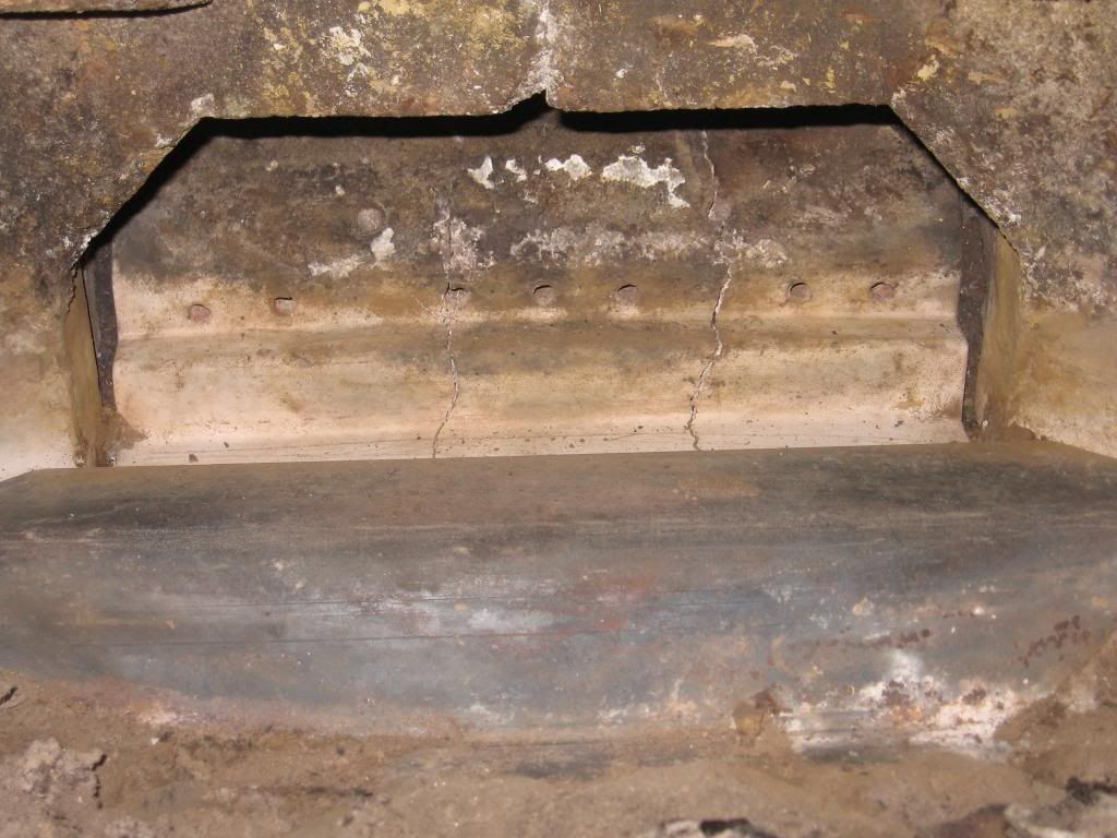

Should I be worried about this? Harman TL 300
bigbear
Jan 3, 2010
30
PA
I just shop-vacced the inside of my stove before lighting a fire and saw these cracks at the bottom of the combustion chamber on my Harman TL 300. The last fire of last winter the gaskets that hold the combustion package in place fell out, but apparently according to my dealer its no big deal. Now I see these cracks. Is this something I need to be concerned about? The harman logo brick is missing in front because it kept cracking and at $40 a piece my dealer told me to quit buying them.
[Hearth.com] Should I be worried about this?  Harman TL 300
Others may not but I would definitely be concerned! I would not burn the stove until it was repaired. A temporary fix would be with furnace cement.
I wouldn't be concerned with those cracks as much as the rest of the "stuff" behind that refracory. In my experience, those cracks will just be a glimpse into the damage that has taken place behind the scenes. This type of stove has been plagued with combustion package failure. How old is the stove?
