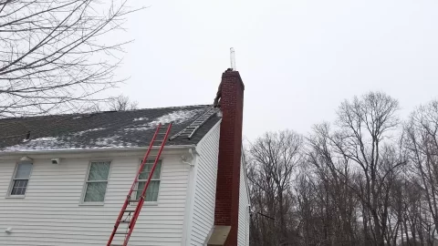

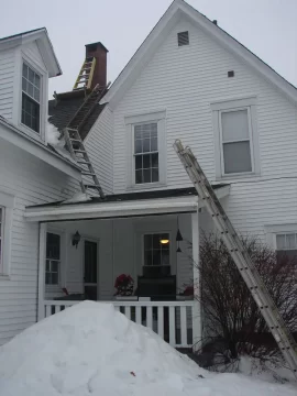

You didn't describe what kind of adventure it would be to clean from the top down. Is your roof 'walkable?' If so, cleaning with a brush and rods isn't all that hard. I use a poly brush (when I top down, see below). There are raging debates on the site about poly vs. steel brushes, but we'll leave that for others. Being at the top of the chimney lets you get an up close look at the cap, the weather sealing and the masonry of the chimney all at once. It also lets you get a face full of soot, so wear a mask (dust protecting, not gorilla). Cheaper than buying rods is using the rope method. It requires a helper or several trips up to the roof, and down to the stove. Brushes have a loop on one end, and a threaded stud on the other. A little adapter with an eye is available to wind on to the stud. Drop weighted rope down, shove brush into flue, and pull down and back two or three times. I started with this method, no helper, then I bought rods.about $8/ea I think.
Then I learned about the soot eater. Here's the reason I bought one (two actually):
[Hearth.com] Should I Clean my 6" flue pipe myself?
That's right ladies and gentlemen, four ladders, a ridge hook, two roof brackets, and a plank. Lifting off the bluestone cap is a special treat. So the soot eater is, for me, much safer and far less strenuous. I still do that crazy setup once in a while to get a good look topside, and to confirm that the soot eater is doing its job. It is.

Ok, I won't complain about my climb any more, I promise...

Well, could be worse. Still kinda involved. Whether or nor to go up there depend on your comfort level. I climb ladders and scurry around on roofs a fair amount, but it's not without risk. I suppose that's why chimney sweeps make the big bucks.
Hard to be sure, but i'd bet that a 28' ladder would get you to the roof on the upslope side of the chimney, and a 32' would reach the chimney top. A bit scary for some, but arguably to not step off the ladder.
