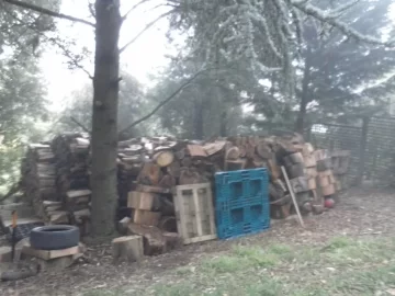

i too have to stack in the 'cube'. I have just started burning 24/7 this year. I am 2 months in with mixed results depending on wood species.
My cube is 25 rows long x 4 pallets wide. Here's some pics. i think there is a bit of mould in there - not sure if that's the cubes fault or if it was on the wood when i stacked it.
The wood i am using now has been stacked since March 2012 - so just over 12 months. some will burn very hot and long - others i had a problem with but i think it was rotten when i stacked it and it never recovered. i was going to try and stack enough for a full year in single file but it never happened and the pile keeps getting bigger. Overall though i have managed to keep the house very warm 24/7 with zero creosote build up which at the end of the day is what we are trying to achieve.
the 3rd picture is how much i have used so far this year 4 rows of 4 pallets. I have started to top cover a couple of weeks worth just so its not wet when i have to restock the stack near the front door. i just drive down fill up the Ute and restack right out side the front door - it works for me. i made the rack out of an old bed i was throwing out.
