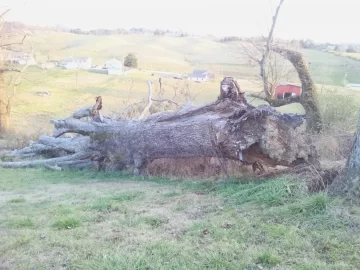

Lady advertised free firewood in local "Yard Sale" group of Facebook. I saw it about 15 minutes after she posted it and she already had a reply. She said it was huge and over 100 yrs old. The first guy went and looked and said he didn't have a saw big enough to handle it so he bowed out. I went and looked and told her I was afraid to tackle it too. I am having second thoughts about it now and am thinking about doing it. The pic does not do justice for this thing. The end closest to the camera is nearly 5' in diameter. The first limb you see coming off the side toward the top with moss on it is about 30-40' from this end. It is probably 4' in diameter there. Look in the background and you can see how far the rest of it extends out. I have a 24" Husquvarna, Husky splitter from Tractor Supply and a 10' trailer to hook up to my truck and can haul about 2000 on trailer. From what I understand, it has been down since a storm last Spring. The lady said there is probably $2000-3000 in firewood in it. I don't quite think that much, but well over $1000. I don't exactly like the poison ivy vines running up the side of it either. I would have to cut it in chunks and split on the spot just to load for the many trips I would have to make.

Should I do it or pass?
Theres alot of wood in that tree. Ive never tackled one that big but I imagine splitiing it could take awhile. Imagine how many reloads would be in one normal sized cut out of that thing.
The only way I could figure doing it is to try to get a square cut on the farthest end and then work in about 16" for cut length, then use the 24" bar to cut as far around as I could. Next, I would stand at the end and cut around what I couldn't reach, let it drop, split, and then move to next 16".
I'd try it this way:
Bury the bar on a normal crosscut, then once that cut is done, do a rip cut from the end of the log. Then continue the process. If you are facing the butt-end of the log, you would need to work from right-to left in order for this to work.
Lots of work in that log, and lots of wood though!
Hope this helps!
You need an aggressive chain on your saw for the rip cut but its definitely doable
There would be more than a years worth of wood for me in that log i think
I can tell just by looking at it, that the tree probably has rot in it. I'm betting a good portion of that tree is either hollow or really soft, by the looks of the rootball. By the looks of that picture, someone else has already been 'picking' the good stuff off of it, looks like a lot of the branches have been taken and that would have been the good stuff on that tree. yes, there is still good wood on that tree, but I'd venture to say the bigger part of that trunk is junk. Worth going and looking at it either way. I wouldn't be paying a single dime for that, as there is going to be a lot of waste wood if the trunk isn't any good.....
As for cutting big trees with a medium sized bar, it can be done if done properly and carefully. I would start at the top and work your way down to the rootball. When you get to the really big parts of the tree, I'd be cutting straight down through the round from the top (you standing at the log, looking at it from the cut end towards the root). Make a pass straight down through that point, as deep as you can get your bar into the tree. Then, go to either side and make a straight down cut. You'll end up with "orange slice" pieces, which you can take to your splitter and make your splits......
Let us know what you decide to do, and we like lots of pictures here, too.....
With those dimensions, there are maybe 6 or 7 cords just in the trunk. Do you have the space to store that much? What's the species? I'd skip it unless I had few other opportunities, or felt like a challenge. It's obviously harder and more dangerous than average to get this stuff, so why?
I'm with Scotty on this one. Could be a bunch of bad wood in there and it will require caution but is is most likely worth given its so close to you. You may think about renting or borrowing a bigger saw although that 24" Huskey will cut a lot of wood. Mean, tree chomping chains are in order as well as an extra dose of safety. Have fun and WE WANT PICTURES!;lol

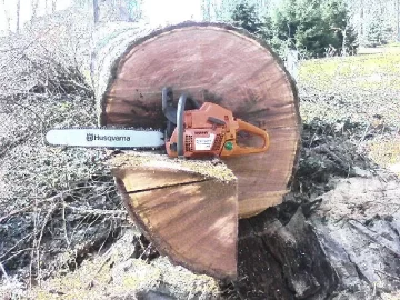

Having dealt with a really big oak recently, I will describe what I did and try and relate what you are looking at doing to how I handled it.
Having the trunk suspended will make your life easier, if you attack it this way-
First, get some rounds to use as a crutch for beneath the main trunk. I would go 12 to 15 feet back from the root ball and place some 4 ft long logs under the trunk to suspend it after you cut the small portion of the root base that is, or appears to be holding the trunk off the ground. Once done cut that small crutch of roots away to get a complete suspension of the main trunk.
Second, make 2 cuts with the grain; from 3 to 9 and 12 to 6. Go in at least as deep as your log length is desired. You have now created a log with 1/4 sections.
Third, cut the top 1/4s away, one at a time. As each quarter is freed up, it will drop on top of the lower quarter and you can roll if off and move it to your trailer. Cut the lower quarters off and do the same. This will make both the cutting and the moving more manageable. You will not have to roll a whole round in order to break it down either. That is no fun.
Repeat as needed. You will have to prop the trunk again as you bypass the logs you set to suspend the tree.
I have always, and will continue to always cut downed trees from the top to the bottom, unless the diameter is greater than 35 or so inches. This pic shows the 24 inch bar on my 359 as I did just what I described above. One of the main reasons I did this tree in this manner was a condition which seems to exist to some degree with your tree; hillside location. My tree was perched over top of a 40% grade. If any round log hit that surface, it was going down that grade into a creek bed. I did not want to take my splitter to the creek bed, so I worked out this method.

I took an oak that was about 6 cord this summer. That was a big job, a lot bigger than I thought to start with. Ended up keeping me busy for a while. It was a lot of work but well worth it.
That tree is doable, but will be work. First question is species, cause if it ain't top notch fire wood I'm charging to remove it. At this point, that ain't $ 1000.00 worth of fire wood, it's a big piece of yard waste that's gonna cost to get rid of. Second question goes back to Scotty's post. How much waste & hollow trunk is there? Third question is how much foreign material is in that trunk? I've taken apart several trees that size, & most have dirt & debris in the hollow part of the trunk that eats saw chain like a fat kid on a twinkie. That oak trunk in my avatar was a solid healthy tree that was cut to make room for a house. 54" at the bottom & 48" DBH, big & heavy, but clean. 1.5 days with 2 men & a splitter from that lot to my yard. Yes, we were tired. If you need wood go for it, if not tell em $ 500.00 for removal & disposal. A C

When I first saw it, I was shocked with it's mere size. That is probably the largest tree I have ever seen, not to mention tackling it for firewood. I have thought about it all day and it is like a challenge that I can't get out of my head. I sent the lady a message a few minutes ago telling her I was interested, if it is still available. This project would definitely require pictures for bragging rights, to say the least. If I can get it, I will post the pictures and give updates.

Please pardon me but I just had to laugh at the estimate of the amount of firewood there. If it were really worth $2-3000, why on earth would anyone want to give it away? If that was on my property then I'd get it but would not consider it if I had to go somewhere else to get it. I'd pass.
I dunno....I'm always up for a challenge (against my better judgement sometimes).Hit it a few times with a heavy hammer or axe along the trunk every few feet,different sounds can tell you of hollow or rotten patches,also where its sound wood.If its 50% or more decent,I'd go for it.Have several older chains for backup,you'll need them if much is bad.Decay/dirt/grubs etc really dull chains fast,

I sent the lady another message last night telling her I have thought about it and may be interested if it is still available. She replied back overnight saying it was still available, but they do want it all cleaned up. Before agreeing to anything, I want to get a better look at it and the surroundings. It is 7 miles from my house. When I looked at it, I parked on the side of the road and walked maybe 20' toward it. I wanted to meet with her and talk it over after work today, but rain has set in and is supposed to rain 4-8" between today and next Wednesday. I am about to send her a message explaining. I will also explain to her that if we come to an agreement, I will get it all moved but not in a couple days or even a week. I have a full time job and a 26 year old son who can help. It is supposed to be winter here, but forcast is for low 70's for Saturday. It is normally 30-40 for a high this time of the year. I will also explain to her that I am not as young as I used to be so I won't be there slinging sawdust when it is 20 degrees. This would have to be something I can do at my own pace and not rushed.
My wife pretty much hit the nail on the head when she said she thought it was stupid and that it must be one of those guy things. I know that deep down in most of you guys' hearts, you would love to sink your saw into this one just for bragging rights. I don't know, but would love to have a pic of the big Husky sitting on an end cut of this tree and post it on here. Contrary to what you can tell in the pic, this thing is ginormous. I had thought about the hammer trick to see how solid it is. I don't even know how much of the tree is on the other side of the main trunk. If this thing could be hauled to a sawmill, I know there is enough lumber in it to frame a large house You can see the limbs sticking up behind it but I haven't walked around it. I am starting to feel like a kid on Christmas Eve.
