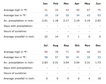

P.S. I'm including a screenshot of average temps from usclimatedata.com but these numbers do seem high to me but are probably accurate.

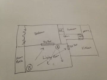

Now I have a question about where to install the stove. In the attached picture, I was going to put it in location A because it would be close to the center of the home and near the 2 doors and near the chimney in the center of the home. The installer who gave me a quote said not to put it there because the fans would blow the air towards the windows in the living room and not towards the doors. If I put it in the corner of the living room the fans would blow it towards the doors. Also the chimney would need a insulated flexible flu and if we put it in the corner we will install a rigid triple wall flu chimney that goes straight up through the attic (and 9 ft above the roof line) with no bends or angles. Is that high enough with strong winds coming from the lake? If I put it in location A it would enter the chimney through the wall on a 90 degree angle and then the chimney is offset going through the attic so the flexible flu would have a bend in it there too. I realize the bathroom and pantry (which will probably be turned into a laundry room) will struggle to get warm, but I want to know which location for the stove will work best. We are probably going to seal off the door going upstairs and not heat the upstairs. It's just me and my wife right now.

1. Is B a better location for A?

You want your stove as central as possible. Have your fans moving cold air towards your stove, most of the time it works better than trying to push hot air away from the stove. Rule of tumb is softwood will take a year to season and hardwood two. But it all depends on climate, location, size of splits, spicies of wood way of stacking it etc. I don't really think you would burn that much wood with a modern stove. In my opinion 8 cords would be a high number, 5-6 is mostlikely. If i was You i would start scrounging wood now. Instead of buying ify wood I would rather buy compressed fuel bricks like eco bricks or northern Idaho energy logs for example. They are great to burn, a bit more expensive than a cord wood at least in ct but there is no guessing game, you know what you pay for.
Hey!
1- rooms will heat up no matter where the stove is. Once the warm air reaches the top of the doorway (from the ceiling down), it will start creeping into other rooms. Location A is more central so in my opinion, A is the best. Less distance for the heat to travel.
