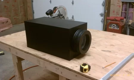

I hired out my first chimney installation. They were 1.5" to a joist in the attic instead of the required 2". I made them redo the ceiling box to get 2". The inspector never looked in the attic and would never have seen their mistake but I did. The trim ring on the ceiling support box was plenty large enough to cover the adjustment. Maybe yours will be too? The small shift required could probable be accomplished without disturbing the rest of the run. There's usually a little flex in the joints.
This is another reason I like this type of ceiling support box. The box provides the 2" clearance and the insulation shield so you don't have to worry about underframing.
  • [Hearth.com] Should I get a Blazeking King or Princess?
