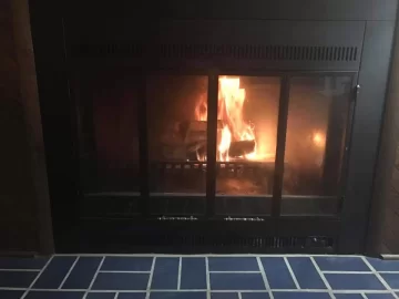

I already have a cumberland gap woodstove which does a good job heating most of the house. This fireplace doesn't get used often(only second fire in four years). I think we are redoing this room this summer and hearth(changing to stone and nice mantle) and hanging a TV above the fireplace. My question is, do I need an insert? It's not really a need of heat? More of a drink a whiskey and watch TV in that room kind of place......

No, you don't need an insert in this circumstance.
If the stove does a good job at heating most of the house just imagine how warm it works be with the addition of an insert. It would be an expensive upgrade if you don't really use it. I have both in my house, a stove and an insert. When it gets really cold, single digits, I have them both going and the house gets up to 70s.in my house they are on opposite ends so that helps.

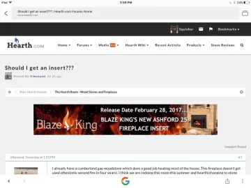

Ashford Insert?
There's a banner ad that I get near constantly advertising the release of the ashford 25 insert. Release date feb 28 this year. But if I click through to their site there's no info on it?
Prolly the Sirocco 25 with a cast iron face and surround.
Here's a screenshot of the ad.
