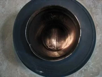

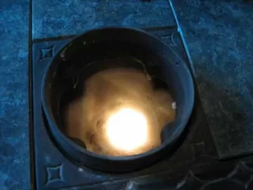

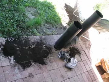

Okay, you guys have been holding out on me. None of you mentioned that cleaning a chimney was fun! I should have been a guy. I climbed up there, took off the cap and to my delight found very little creosote in there, certainly no shiny stuff. I went down it a few times with my wire brush, and almost nothing came out the other end. I'm happy to see that packed insulation class A chimneys do just fine staying warm in New England winters. My inside stack temp was only about 350, so I was concerned last year about it being too cool up there.

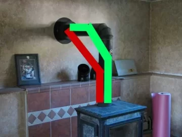

The less good news was the inside. The buildup in the single wall pipe was much greater than I wanted to see. It reaffirms my suspicion that my setup with the hard 90 angle sucks. I already know the draft to be almost non-existent. I will be modifying it to something with a softer angle. I was thinking of coming out of the tee about 12", a 45 to another 12" section, and then another 45 to the 12" leading to the stove. (assuming it meets clearances of course) The other idea would be to just shave off about 3" from the section coming out of the stove, open up the 90 angle to about 120 and that would leave the piece to the tee with about a 2" rise. Any ideas on which would work better?
I've posted a few pics of my cleaning results, and one of my ideas for pipe modification. I do have a question about the baffle. Since I removed all the single wall pipe, and vacuumed the stove from the opening, do I still have to remove the baffle?

Why double wall? I think the creosote buildup is more due to that hard right angle. The temp's been staying around 350, so I don't think more insulation's an issue.

Double wall pipe will keep more heat inside the pipe and form less creosote. Single wall pipe will cool faster and in turn leave more creosote.
Not to say that the 90° pipe is not a problem but i think double wall pipe will help just as much as two 45° pipes and you can keep the "look" you have now.

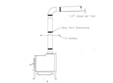

Also when installing a pipe with a 90° like yours the horizontal run is to angle at 1/4" up run per 1' of pipe. I'm assuming you knew that but if you didnt look at the posted pic.
