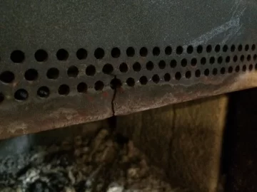

Should this crack worry me? Hampton HI300

I think these holes are for the recycled heat to give the glass a wash. I'm thinking I need to replace my gasket anyway, wondering if this crack is from air leaking in and overheating that area. Thanks

Looks like a stress crack. Your theory maybe true but I would not worry much about it. Though that may just be me.
It does look like an area of poor gasket contact. It may have overheated that area. How long has it been this way?
In that location I wouldn't be worried but would check the gasket as it was likely the culprit.
that's a common area for all regency's to crack at over time. Also check really close in the corners and at the cut out for the door latch, you may see the start of small cracks there. It seem any unit over 6 years old that we come across has a crack somewhere on the face.
Thanks guys, appreciate the input. I only noticed it at the end of last season's burning. My unit is 6 or 7 years old I guess. I'll try and tackle the gasket before I get fired up this year.

Underneath right where the crack is..is completely rotted out on my hampton...I have to pull it out and see if i can get it welded...for now i will use furnace cement...This will be my last steel wood stove,they are way too expensive for this to happen.

Just discovered the same thing. Not sure how to proceed.

I am a regency dealer and that is covered under warantee get ahold of your dealer. We honestly dont see that many cracked but i have see 2 with cracks like that that have spread further.
Not only are there cracks in the air wash manifold, but it looks like a chuck of metal in the middle rotted out.
The good news is that the crack is a round hole and that means its likelyhood of spreading is less. Holes are often drilled to stop cracks.
A tech person at the stove dealer is in touch with the company.
Yeah they have since switched the design of that deflector to a bolt in stainless one. The old design was a problem
I should say on mine, the front plate with the holes is not cracked.
In my experince once that heatdeflector cracks and warps it is only a matter of time before the front cracks
Here is response from dealer:
Hi xxxx,
Below is the response I received Regency. So currently no problem to use just keep an eye on it and get back in touch if you see a crack in the steel body. At that time we can put in a warranty claim.
“Yes, this is the smoke deflector. There isn’t a replacement one and the current one can’t be retrofitted.
Currently, if this is the only issue with the unit, they can continue to use the unit. Just monitor that area. If the steel that the smoke deflector attaches to ever cracks, then discontinue the use of the unit.”
I would tell your dealer to go back and insist on a replacement. Regency has replaced stoves for us with less damage.
