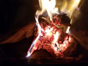

Total success! I loaded 3 cedar splits with some small hickory limbs and pine wood working scraps for kindling. Stovetop was cold this morning. Opened the door and put my hand inside to confirm no smoldering embers. Zippo. Room temp inside the stove. It got down to 37F outside. Temps inside the house were 67 this morning. So this small load wasn't quite large enough to hold the house at a nice warm temp. But the exercise was a total success. This stove can be run low and slow to put out heat for 20+ hours off of one full hardwood load. Or can burn through a small softwood load quickly to dump some BTUs into the inside air and be totally out by the time the Sun is up too.

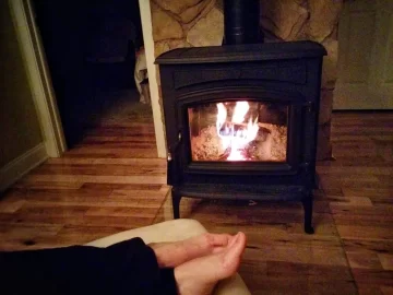

I didn't get home till 9p last night. But the babies were sleeping and my wife and I got some quality time by the fire before retiring. It was just perfect.
