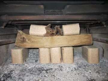

Saw this thread this morning and luckily I remembered to take pictures. Started this fire 30 minutes ago

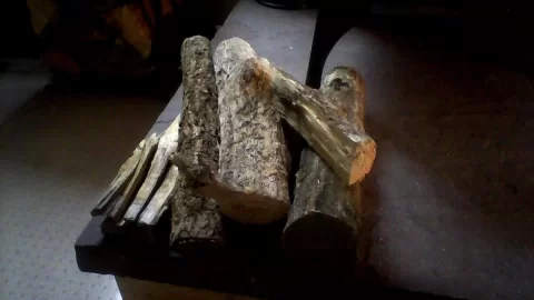

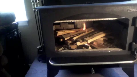

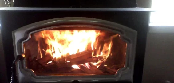

Here's how I just got done starting the stove from letting it die down to pretty much nothing. (Well, 6 hours ago) Temps were still in the 90s on the outside of it, and I wasn't looking to get a raging fire going quickly. Let it go for about 15 minutes with the doors open to view it and hear it as the family was in the room. After that, closed it up and it was up and roaring after 30-45 minutes later. Then I backed the air down to cruising range, ohh and before I lit it I moved the two top bricks closer together. In the middle are some starting pellets, fat sticks, and cardboard, normally doesn't take more then that unless the flue is quite cold.
I learned from here! Top down starting is easier, and it helps the secondaries kick off a bit sooner. And yes I know, that big huge split in the middle isn't ideal, but it was very dry and went up quickly. Normally that would be 2-5 small splits to get it going quicker. Didn't need much heat, it's in the 20s and 30s here currently.

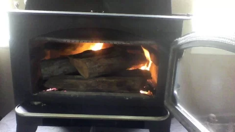

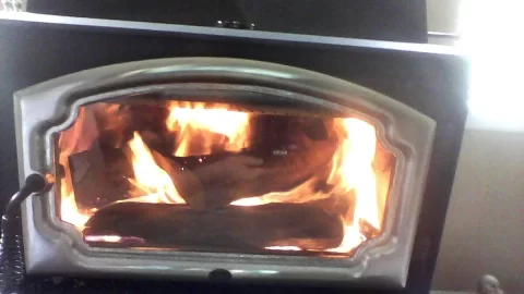

I didn't load this morning, so there weren't many coals when I loaded tonight. Shoved them to the back and loaded for a clean-burning top-down start. Three Red Elm in the back with a White Ash on top. More Ash, then a couple of Black Cherry on top in front. Lit a couple little SC chunks and placed them in the vee. A few Red Pine kindling on the SCs. Aaaaaand they're off!
(broken image removed)
Cherry and Ash burning, bypass closed. :)
