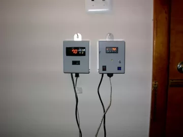

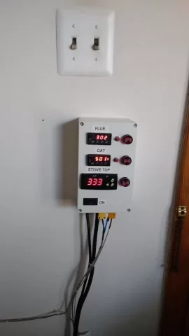

I have posted this before but in case you have not seen it here it is.
This is a 3 channel temp monitor/alarm.
It monitors flue, cat and stove top temps.
Not terribly difficult to make, everything is readily available off the shelf components.
At one time I had two temp monitors in separate boxes, but when I got the BK I wanted a 3 channel monitor all
in one unit so I built this one.

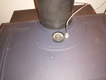

Excellent, curious on how you go about measuring the cat temp. How do you insert a probe in the internal location? How do you run the wire? My GM 60 has a factory analog gauge on the side. Might just leave it or maybe an upgrade.
Not difficult, just drilled another hole alongside the original one.[Hearth.com] Shows us your temp/stove monitors!
