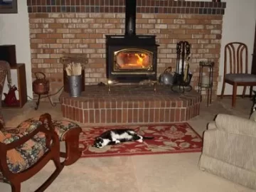

Not too sure about all this but I'm listening too. I have two wood stoves. Both are Jotul 3CB's. One is freestanding in the basement, and the other is on the first floor and set into my fireplace. My chimney runs up the center of my saltbox. It seems to me that the fireplace/hearth installation puts out a lot of heat. The masonry does suck up a lot of the heat because it seems to hold the heat and radiate it for days. The entire chimney radiates heat through the walls, up the stairs, and into the second floor bedroom, into the closets too. Think nice warm towels and pajamas. I read in an architectural building book that a mass of brick will slowly store, and then slowly release massive amounts of energy, more than any other material.. That is the idea behind passive solar features in houses that use the daytime sun to heat a large brick surface. The stove in the basement will fry the basement occupants, nicely heat the first floor, but once it is out, all the heat is lost.
BrotherBart said:
...fossil has a monster free stander out in the open and still uses the blower. For the same reason I do.
And dat's a fact. And we love it. Blower's on a rheostat. Don't want to listen to it? Turn it off. Want to circulate air/move the heat out into the room? Turn it on to some pleasant level. Going to bed in the back room? Turn it up to max. Wouldn't have it any other way. Rick
  • [Hearth.com] Significant heating difference between woodstove as insert or freestanding?
Your stove will make the same amount of heat whether it is in a chimney or freestanding. What happens to that heat after it is produced is the topic at hand. When you shove the stove into a brick fireplace with a big honking heat sink of a chimney sticking way up into the sky, then a percentage of that energy will be lost to the heat sink and blown away by the wind. So your freestanding will be able to deliver that heat to the room and so you can run it less to consume less wood. That equates to efficiency.
