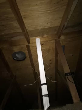

At the risk of serving as a 'good example of a bad example', pic is attached. This is literally some scrap 14 AWG romex I had, and a scrap piece of crown molding. I 3D printed some 'bow ties' to hold the three points where the elements come together (but don't actually touch) and provide attachment points. But I'm not going to climb through the blown fiberglass to get a pic of the backside, so my annotated pic will have to do!
This is a pretty minimal / crappy example, but with digital, you either have it or you don't and this brings in all channels I can reasonably expect to get with perfect clarity - so not really a need for anything more unless I want to get crazy and try for a third copy of PBS from a station 90 miles away.
Even within this design improvements could be made though. Adding a back reflector can help gain in the 'forward' direction at the expense of cutting down on signals from the rear. Adding NAROD elements is supposed to help gain as well.
You can also see my 'signal booster' attached on the rafter support at the right. This isn't so much to boost a crappy signal, more to make sure the decent signal I get has enough strength to propagate down the coax to the basement, through the distribution network and in some cases, back upstairs to the TV.

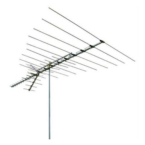

As far as pointing, I believe fbelec mentioned yagi antennas, they are pretty common for "TV" and look generally like this:

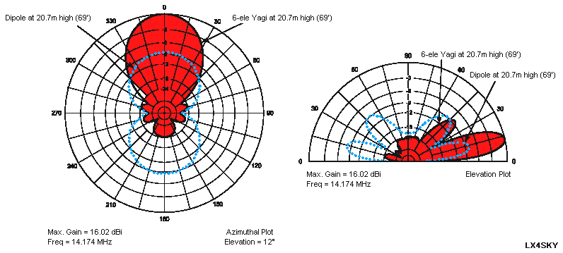

They are good for long range, but the directionality looks something like this, so generally if a station isn't in the big front "F" lobe, it will be hard to pick up.
