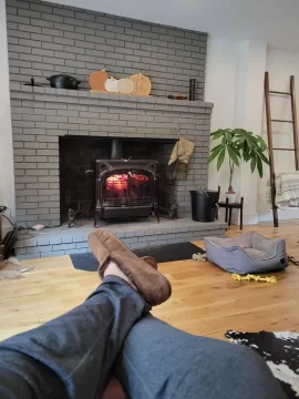

I have a new VC encore. Set up in a masonry fireplace on my hearth. It looks fantastic. Definitely not the easiest stove to use and I'd probably go elsewhere knowing what I know about this stove now.
