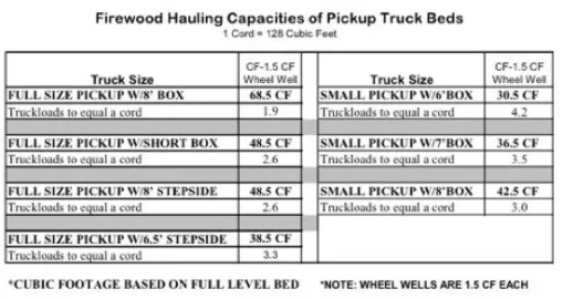

Here's my estimate for firewood stacked (not thrown) up to the top of the bed walls (not heaping) in a pickup bed
6 ft. bed = 1/3 cord
8 ft. bed = 1/2 cord
So if you have a 8 ft. bed the wood would be at least $80 per cord with you doing all the work.
Too expensive for me in my part of the country, but I imagine this may interest some in different regions and circumstances.
OK 8 ft. bed = 1/2 cord

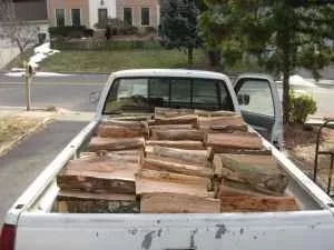

Here's a picture of 1/2 cord in a full size, long bed pickup.
