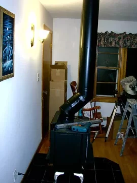

I went with Simson DVL double wall. I had plenty of clearance and could have used single wall.
My chimney is a little on the short side and it has an offset so I figured the double wall would be a good idea. Drafts fine no problems.
I do think DW should last longer, the inside is stainless steel, the single wall on my basement stove is only 4-5 years old and has some corrosion on the inside. I vote for DW.
Just curious, why did you elbow at the stove? It's more common and would draft a bit better if the elbows are at the ceiling box. I'm glad it's drawing good for you.
Just curious, why did you elbow at the stove? It’s more common and would draft a bit better if the elbows are at the ceiling box. I’m glad it’s drawing good for you.
I figured it would be a little easier to clean. The brush can goes straight down until the very end, then it would make the jog and come out in the stove.
