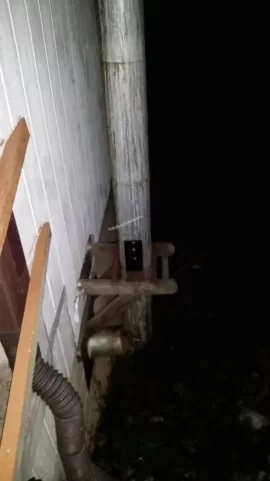

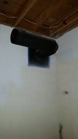

Here's exterior and interior pics. The interior pipe is just swiveled up out of the way as the ceiling in my shop is 16ft high. I would love to be able to safely line this versus installing a whOle new stack.

Is it an actual triple wall thimble going through the block? Or a triple wall "crock" ready to adapt to a real chimney on the other side? Ironically, they put the best piece in the place where it was least likely to need it :(
Regardless, from what I'm seeing here, I'm going to say that a whole new chimney is in order... I'd hate to see you order chimney parts and not be able to attach it to whatever they are using to go through the block there.

Its a full triple wall thimble. No, the only tag that was on it was a barcode and its very worn off. If I have to order a whole chimney will I need to replace the thimble since it is 8" instead of 6" like my new woodstove? or is it ok to use a reducer on the outside and inside?
If you are doing the whole thing anyway, the parts need to match, so finding a reducer on both ends of that thimble, just to match with that brand for 1 piece, would be ludicrous.

I reoriented the pictures and looking at them I agree with Pen. It looks like a bad installation. On the interior the single wall is too close to the ceiling joists. There should be a minimum of 18" clearance. The pipe outside looks like something is amuck. There is all sorts of crud and snot dribbling down the pipe. It does not look like a proper installation from the pipe to the braces. And a 90 deg elbow should not be on exterior pipe. I would replace it all and connect with double wall on the interior.
I reoriented the pictures and looking at them I agree with Pen. It looks like a bad installation. On the interior the single wall is too close to the ceiling joists. There should be a minimum of 18" clearance. The pipe outside looks like something is amuck. There is all sorts of crud and snot dribbling down the pipe. It does not look like a proper installation from the pipe to the braces. I would replace it all and connect with double wall on the interior.

There is a remote chance that the triple wall is a currently made pipe like DuraPlus. No guarantees but remove the connector and the exterior elbow and post good lit pictures of each end. Perhaps we can identify the pipe. If it is DuraPlus you are in luck. But based on the way this was hacked together I would guess that it is not even class A pipe used for the thimble.
Even so, it sounds like the stove he's running is 6 inch, and the thimble is 8 inch. That being the case, it's time to just junk it. Would seem worthless to stick with 8 inch the whole way, for the added cost when the stove would work best at 6.
Good point. I was trying to find some redeeming factor, but it's a stretch.
