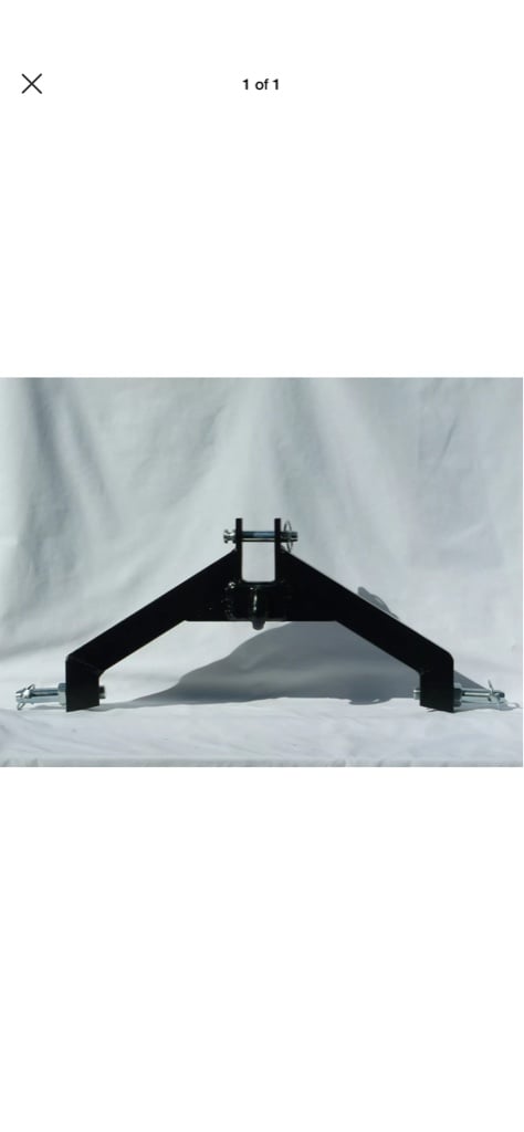

Recently ordered this to use with the New Holland to move some logs out of my woods up to the house. I think this will be nice, instead of cutting all the logs in the woods, then hauling to the house to split. Excited to try it when it gets here. I’ll post some updates when it arrives!
I use something very similar to that. Get yourself 12 feet of 5/16” chain with a slip hook on one end and a grab hook on the other, and consider your rig complete. Next step would be tongs, but I’d definitely get the choker chain first, it’s more versatile.

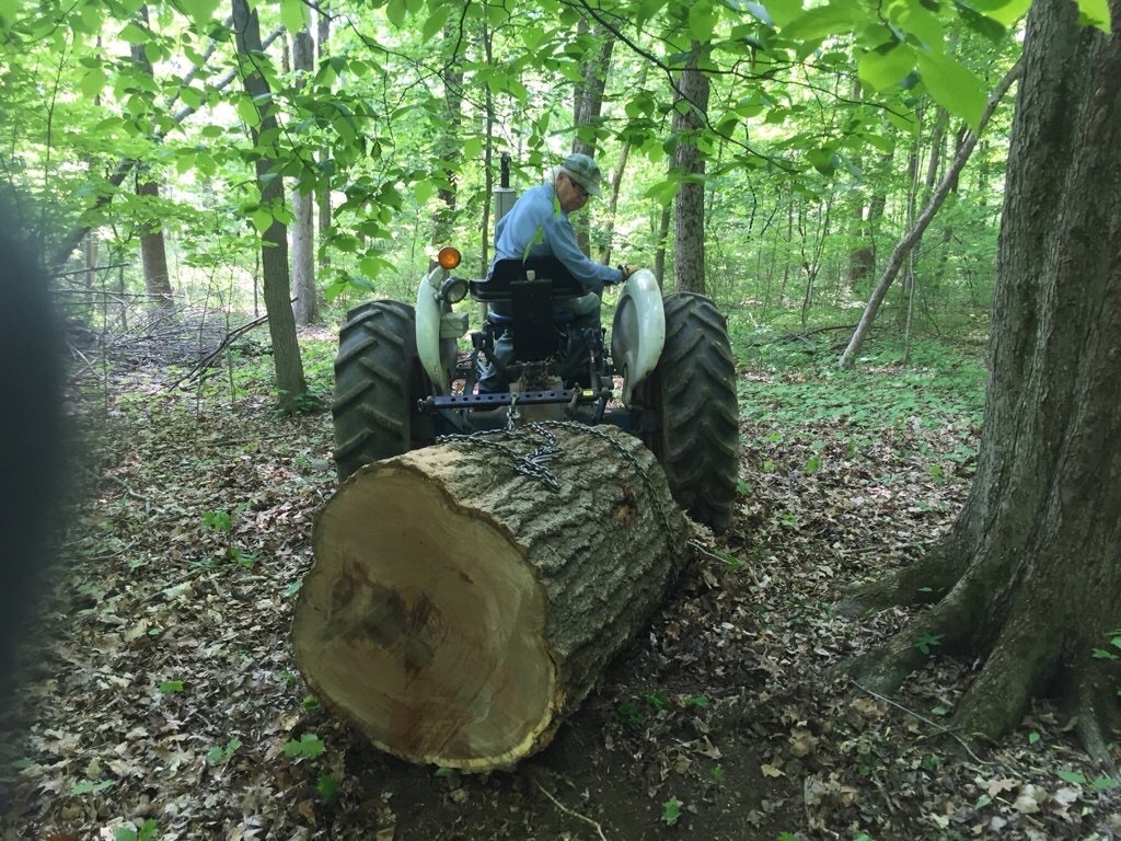

Another option is just a simple drawbar on the lower links, if your tractor is big enough. Here’s a log I skidded that way about two years ago, although that’s my cutting partner on the tractor.

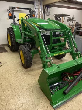

In addition to the chain grab hook on my 3pt forklift frame, I just added chain grab hooks to the top of the bucket of my new tractor, to aid in skidding. The old tractor had one hook, but someone on this forum with a pair had shown me how I can lift logs with two pairs of tongs, on dual hooks.

That one is easy enough for me to make- Ihave a something similar that has a 2" receiver on it on the bottom bar - easy change for whatever ball hitch size I need or a hook

this attachment has been very handy for moving logs. I’ve been pulling logs that are about 40’ in length. Some hard wood some soft. It’s a handy attachment to have for sure. I looked into making one, but at the price point I found this at, it was worth it just to purchase and try it
