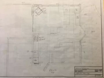

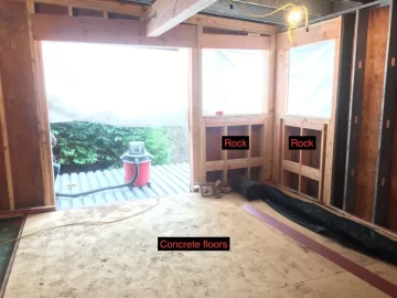

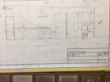

Hello all, First time posting here. During my hours of reading and local stove shop visits I have been narrowing down my choices for a new stove. I am building a 440 sq ft studio/man cave/workshop/guest room onto my 640 sq ft shop space. The shop has never had heating of any kind and will be a welcome addition in winter months. Both spaces are insulated with 8' flat ceilings. Concrete floors. Northern California coast (think Oregon coast). I have attached the floor plan of the studio and photo of stove placement.
The studio and the shop can be closed off to each other. When the shop is not being used, there is only a 440sqft heating requirement. The long and slow numbers on the modern cat stoves is impressive. The stove will be in the studio on the opposite wall from the shop. The studio has a 600cfm range hood and a wall vent with fan to the shop. (see plans)
Use: The studio and shop will be used full time as live in and part time workshop. Shop has small non partitioned office and 1/2 bath+laundry. Outdoor Shower.
The contactors are cutting the roof next week and I'm coming down to decision making time.

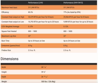

Here are the #'s on the Boxer:

Check for range of output since those inserts took hits on low end output
Yeah, these numbers don't look particularly low.

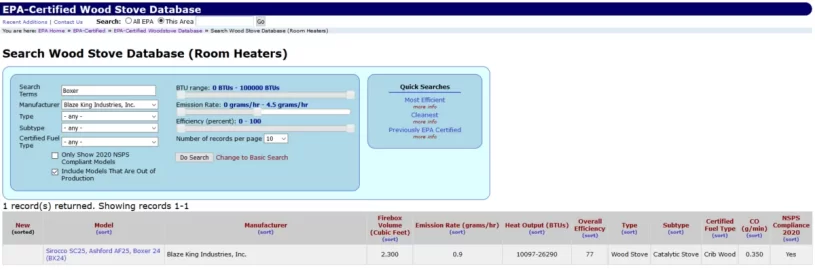

I've had good luck using the EPA output numbers to compare stoves. The stoves I've run, the numbers seem close when used to compare relative output. You have to use the advanced search, then plug in search terms to find what you want sometimes..

There is about 9' floor to top of roof. Flat roof = ~11 foot of chimney to get the recommended 15' of draft.

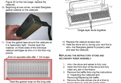

The Hearthstone Green Mountain has two cats? Am I reading that correctly? I took a look on their site and am not seeing that info. That would be a new one.
It looks as if the cat is comprised of two sections, which is the case on the Ws Keystone and Fireview I've seen, but only on their ceramic cats. I haven't seen a two-section steel cat. I can't find one for sale to get a price..may be too new still.

Pouring concrete floors today and as soon as they cure enough, insulation is coming in so I need to have that chimney hole figured out this week. Coming down to it!
Sounds like things are coming along nicely. Are you insulating under the concrete floor?
When choosing the location for the hole be careful to leave a few extra inches away from the wall for the sake of flexibility for future stoves, easy cleaning, and a little extra safety. It is not easy to go back and get another 2” when you want a different stove. Many (most?) of us here have had multiple stove upgrades over the years.
