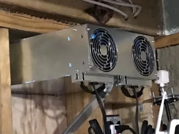

Hi no there is not? Our crawl space is also attaches to our basement that is conditioned. But there is a door separating them. Everything in the crawl space is closed and there is no ventilation? Should there be? No one has ever said that.
  • [Hearth.com] Smell after crawl space encapsulation
