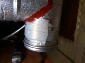

I used silicone tape on the cleanout T. Easy to remove when needed. I've never met a cleanout or elbow that didn't leak.

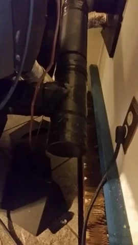

I used Sharkbite brand silicon tape I found at Lowes. You just wrap it tightly around the cleanout (or any seam) and it bonds to itself. You can cut it when you want to get the cap off, and then restretch it and stick it back together until the next time. I also used RTV Silicon around the angled pieces of the T, because the tape won't go around that very easily.
It looks pretty sloppy because I've cut the tape a couple times to take the cap off and clean it, but each time it has bonded back together, and since I started using it, we've been smoke free.
