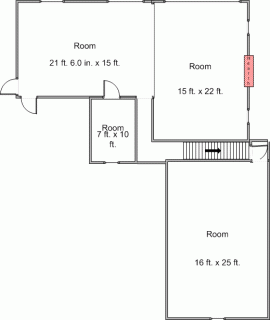

I have been thinking about wood stoves and smoke detectors. It seems to me this could be a Goldilocks situation (not too near, not too far). My house, as constructed, does not have a smoke detector in the kitchen or family room (they connect in an open floor plan). I'm sure the idea at the time was to avoid false alarms from cooking (there is a smoke detector on that floor, way on the other side of the house and not in the area the diagram below). I'm planning to put an insert in the family room fireplace. Where do you have your nearest smoke detector?

In my workshop (10' ceiling), I have a combo smoke/CO detector mounted on the ceiling less than 5' away from where the stovepipe adapts to the chimney. It went off once, during my break-in fires when the stove finish was curing, that's the only time. There are code requirements that address the placement of detectors, and there are specific mounting requirements in the manufacturer's documentation which comes with the detectors. Rick
Yeah, I read some of the code requirements by Googling the topic. I didn't see any reference to wood stoves, though, just so many per floor, one in each bedroom, etc. There is room for interpretation. This arrangement must have been code compliant in 1999. I think it may be compliant with current codes, too, because we have a detector on that floor of the house and the rooms I'm asking about are not sleeping rooms. Anyway, I'm just curious about other people's setups.
