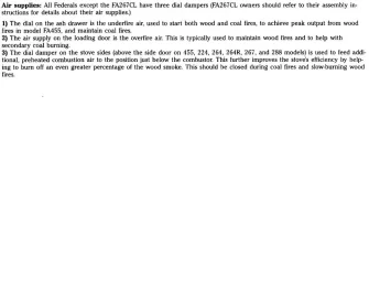

Dutchwest 207 cl not sure about other models.
They had coal/wood option, brass spins dials for over fire air, under fire air and a dial at the top for the cat.
However they state in the manual that the underfire air coming from the ash pan shakers was for coal only. Over fire air knob is stated as wood fire, along with cat knob, for that primative system.
Doesnt stop the older gentelman who has it, when he burns wood from using the underair. No use in explaning, win some lose some.
Hence, so many Dutchwest users had watped parts, etc. They were not supposed to use the ash pan air knob!.
Another pre EPA stove with air intake bellow the fire was the Surdiac, they had several similar models, the Gotha 513 and 713, later the 515 and 715, that I know of. Great systems IMO, thermostatically controlled air intake door was located behind the stove and directly behind the ash pan feeding the fire from below.
I disagree see the text snapshot from the CDW manual..
