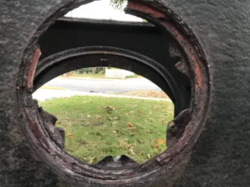

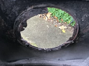

This is what happens if water drips onto your stove by the outlet pipe and collar. Wet ash and creasote is highly corrosive.
0BDB37E3-D0FA-4E9B-A897-C10C3548B91D.jpeg 5D0FD149-8D8E-4DDA-AD99-9A5B56FD7F59.jpeg 1DC798FA-8612-4600-B509-B1F70374CC76.jpeg B365F7EB-1C23-49B1-88FF-06C9CC4543E9.jpeg
Reactions: MR. GLO
