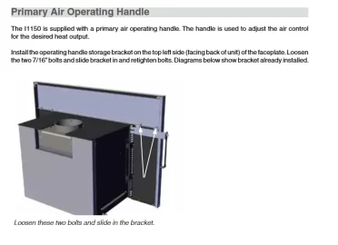

On page 22 of your manual, it sound like installation required fitting of a bracket or something, that might not have been installed for shipping purpose. What do you think?

That is just the hanger for the handle
Well, it was worth a shot. Hard to visualize.
