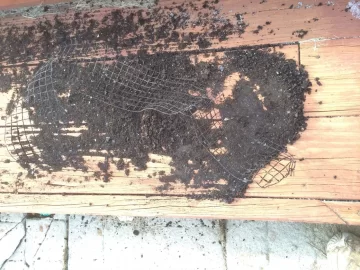

I have a hearthstone II stove, with regular stove pipe inside the house and insulated security ss insulated pipe on the exterior topped with a cap and bird screen.
Today I noticed after just feeding the stove that a couple of the joints were seeping smoke. It was a small percentage of the smoke coming out the top of the stack. The stove had been burning for over a day but the temperature just dropped ten degrees when I saw it seeping out.
This type of pipe is just twist lock with no fasteners.
Any ideas why it started it and if I should be concerned?
There should be no visible smoke after maybe 10 or 20 minutes into the burn. Either your wood is not dry or you are running the stove so cold that the stack does not have enough heat to draft enough. Get a moisture meter and a probe type stack thermometer. The chimney needs to be cleaned if the screen is partially plugged my bet is the inside does not look any better than the screen does.

The screen was almost plugged. I removed the screen and will make sure my wood is seasoned better for next winter. Also going to invest in a moisture meter. I'm also going to try to get a higher stack temp as well.

That is the coolest place and where the most creo forms. Although, once you get dry wood, it should not completely clog the screen.
Ok. Great advice. This wood had been down for over a year but was recently split.
