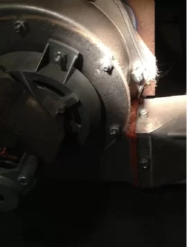

The other day I noticed a faint smoke smell when starting the stove. Didn't think too much of it as it would go away once the fire was good and going. Today I started it, went into the basement for a bit and came back upstairs. I checked on the stove and the faint smoke smell was still there, but the stove had been running for an hour or so. I shut it down, pulled it out of the fireplace and took the side panel off. The attached image isn't the greatest as it was taken with a phone in one hand and a flashlight in the other. One of the combustion blower housing bolts was just as shown in the picture - hanging on by a thread (literally). I checked the other bolts and two others were loose as well. I haven't ever pulled the blower off the stove, as it's only had about 1.5 ton run through it since I bought it new.
I found the nut rolling around in the back of the stove, reinstalled it, tightened the others up, vacuumed out some dust while I was in there and put the side panel back on. Going to vacuum the fines out of the hopper in a little bit. Don't really need the stove today as it's pretty warm outside.
I guess I need to add "check various nuts and bolts on the stove to make sure they're snug" to the pre season checklist. I don't know if those bolts can work their way loose or if this is another example of the lack of quality control at USSC. Based on some of my other findings, I'm going to go with QC, or lack of.

Any thing that vibrates can have the bolts/nuts loosen. They have thread lock though that's your exhaust fan not sure what temp rating thread lock has. THey probably have a high temp one too.
