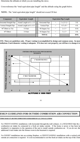

I exceded the carved in stone, written on paper, generic one size fits all general rule of evl for 3" vent. Yes, i am one of "those guys"
I have been researching online alot about these stoves since last spring when i got mine. Most manuals just say at an elevation up too 3000 ft an evl of 15 max for 3 inch..i have ran across one that stated 20 evl for 3 inch... other manuals for other brand stoves give an actuall chart for elevation vs pipe size vs length... so which is actually correct? Who knows.. i already had more than enough 3 inch pipe to do what i needed. So i exceded my manufacturers recommendations and raised my vent another 4 feet which puts me at about 20-21 evl with 3 inch. It is now the way i wanted it when i first started thinking about the install. I got all this pipe super cheap before i started doing any research. otherwise i may have gone with 4 inch and spent alot of money.
So i decided to go by the diagram i kept running accross, googled my address for elevation and decided to give a try.
So now we will have to see how bad it is going to be over time.. after seeing so many diff setups, reading about many problems and thier causes, watching videos of what some people have and have done... i dont think im going to see any problems.

If you stayed at the EVL per that chart, I suspect you are fine. In fact, I think I am at about 17-18 on one stove with 3", and it has always been fine. But elevation is only 562'. The other chart is very generic, and a decent rule of thumb, but one 90 to go up adds 5', and if you have another at the top to go out and a 45' down termination, you're at 13' right there. Say 3' out horizontal and wham! You exceed the generic chart with your vertical, at 16' EVL. A 4' rise puts you at 18' (All that calculated from memory, so calm down folks if I'm off anywhere). Anyway, I use the same chart as you over the less precise one so often quoted (have quoted it myself once or twice, though, I'm sure). Elevation does matter.
I get an elevation between 450 and 510 depending on which map source i use. Stove seems happy and havnt seen any difference at all. Seems more of a gimmic to make people purchase more expensive parts for no reason..
