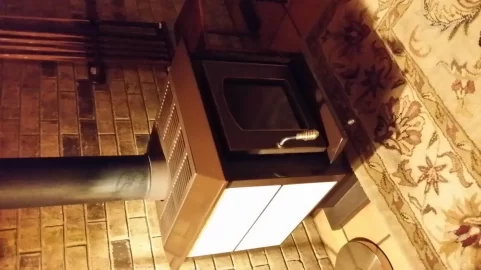

In searching for a bypass I found the serial number plaque! And I think I've found an imposter. This stove looks just like a Kent tile fire but the plaque say ashley automatic heater co. Model number ASP1. Do I have some kind of knock off...
I did not find any bypass control on the stove. Just the damper lever.
Here is the stove.

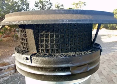

On the top of my chimney i have a cap that has a mesh around it so birds don't make a nest on the summer time in it. I had the exact same thing happen to me when the mesh got clogged from burning green wood, or short fires twards the end of last season. I could shut the door and everything was air tight but as soon as i cracked the door smoke would roll out, so i started investigating and found my chimney top looked like this. [Hearth.com] Smokey Stove
Reactions: Nich
