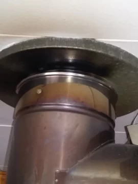

Hi Guys.. My first post here. Hope you can help.
The wife and I moved into a 1970 cottage in the woods 3 months ago. It has a what look likes a very old wood stove. After buying my first chimney sweep I went to clean it out and found it was almost spotless. Forsure the stove was being used before we moved in as there was a ton of ashes that needed to be cleaned out. The thing is we have been using this stove for 2 solid months with a fire almost every day and night without issue... now all of a sudden there is smoke leaking out of the ring that enters the ceiling. I fills the house with smoke. I did take the sweep and cleaned out a lot of creosote and am burning a Sweeping log as I type this.
My question is... can I put some high temp caulk around that flange.. or is it to danger fearing the caulk could catch fire.
I'll be posting pics in a few minutes.
Thanks!

No hight temp caulk won't work none are high enough temp. Some pics might help. Have you had the system inspected by a pro?

Thanks beholler.. no we haven't had it inspected as we planned on replacing it in the next couple of months. As I mentioned it has been fine till the Creosote started to build. Now all of a sudden smoke comes out that joint unless she's burning over 400f. I use only hardwood with less than 15% water content.

If you fouled your system to the point its leaking smoke in 3 months then your wood is not that good, you're burning practices need improvement or maybe more likely, both.
Did you check the cap? That usually clogs first and worst. Once you're up and running you probably need to give more air to burn cleaner.

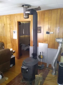

It probably was a couple of times. The temp did rise as high as 600 at least twice that I know. There is a problem with the automatic air inlet on the door. It does not work properly and has a mind of its own, hence the main reason we are replacing the stove. The fire will be burning beautifully at about 350 and the flap is opened just the right amount to maintain it, and then it will decide to just open up fully and the temp will soar! On other occasions the flap will decide to close and suffocate the fire down to 200. This is why there is a knife sticking in it, in one of the photos, to keep it open. For now we only burn wood when Im home to keep a constant eye on it. Our home will be getting a full renovation so things will be upgraded in the spring.

Got any binoculars? If you have a line of sight you can check it with that. Post up what kind it is, some are more prone to clogging than others.
Winner winner.. chicken dinner. Jataxico you nailed it! The cap was about 90% plugged. What a relief to discover this...I now know what to inspect on a more regular basis.

Progress! If you can't get to the roof because of the snow, it looks like you're setup to sweep from the bottom up by removing the cap at the base of the stainless pipe. I dunno how much stack you have above that but you (or a pro) should be able to run a brush up to the cap and clear it. Run a shop vac while brushing and it shouldn't be too messy a job.
Yes Im able to sweep from the catch pot up. Already did it. I put the brush in and then attach a plastic bag around the pipe with a rubber band and all the soot falls into the bag.

Is that an Ashley Columbian? I used one like that back in 1971, bought from the Whole Earth Catalog. Haven't seen one in a long time.
Go for the T5 in your climate zone. Note that it will not be crazy hot and radiant like the old Ashley. The cast iron jacket softens the heat on the sides.
I don't really know but from what your saying it most likely is as the house was built in 1970.
