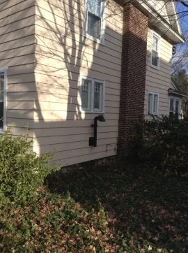

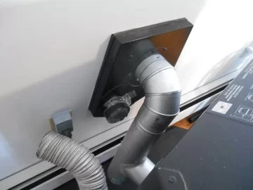

We had a stove shop install a harman p38 this summer. Stove is 4 years old, vent goes thru the wall. After they left it started smoking in the small room where it is. Can't see the smoke but can smell it. They came back and taped up the indoor exhaust pipe, also 4 years old. It helped some but after they left it started smoking again. So we called them back and they replaced the inside pipe with a new one, and extend the outside pipe a few inches. After they left it started smoking again.
I removed the OAK tube, which is smaller than the wall fixture, they had taped that up too, i capped off the wall fitting. Now it doesn't smoke in the room any more where the stove is.
Instead smoke comes in whatever windows are downwind. Not bad, but sometimes the bedroom, sometimes where the dog sleeps. With a breeze we don't get any smoke but the wind dies at night and we're getting it in other parts of the house.
Here are pics of the wall fixture. I think there is something wrong with it, either the 2 pipes are too close and the oak sucks in smoke, or something. In the outdoor shot the small hat above the pipe covers a long slot for the air intake, I'm thinking it funnels in the smoke. Is this a poor design, is there a better way to do this?

I never liked that style of wall thimble.I prefer ones that the fresh air is below the flue pipe.However you need to run the oak as you are creating a bigger suction within your house.When hooked up you would never smell anything as it is being sucked into stove.Startups and shutdowns may cause smell,though.With the oak unhooked enough suction is being created to draw in from every small crack,but in certain wind conditions,with the best install,this may happen anyway.Sounds like you need to do some window work.Best for you might be to run flue above roof edge,but if was mine,being winter,I would add a 90 and go up about 4 foot and see how it does.Also you have wood stoves,do they have oak?
Bob bare is right on both counts. Need more hight on the outside for better draft .

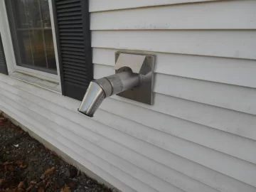

I just installed my Harman Accentra with the same type of wall thimble, a bit differently.
From the stove I go straight out through the wall using DuraVent 3". The connector to the stove plus the straight pipe gives it an 18" horizontal run through the wall to the T connector located outside of the house, then a couple of lengths of vertical pipe, then the 90, then the vent cap. This brings the vent outlet about 32" up and away from the intake integrated into the wall thimble. So far no issues with smells or smoke, and a nice clean fire in the pot.
With your configuration I would add at least 24" to the vertical rise, it may do the trick. Will also help (I think) in the event of a power outage, the more vertical the better the draft to keep the smoke going out.
The thimble is'nt the problem, but the outlet point sure is. You have a large window far too close for that outlet point, and the foundation should have vents in it. Likely smoke can get under the house and show up in any room. IMO, definitely need to get that outlet away from that window.

I think I'd be looking at that window right there level with your vent and any others near by like that one. And I like the idea of going up with the vent outside as well. My own vent goes 23 ft up and out an existing chimney, so clears the roof line ( required 4" vent).. had I run out the side wall it would have been right into the prevailing NW winter winds, not so great a deal. Even if your OAK sucked in some smoke it would be burned in the combustion process anyway not admitted to room air. Your thimble could leak though.

This is my own installation. Again, I hope the inspector finds it acceptable, I've got 24" between the exhaust outlet and the OAK inlet. I've got a couple extra 12" pipes if needed...maybe I should get them configured, lengthen the stack.

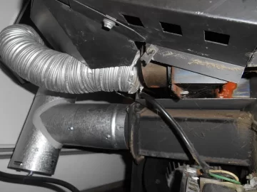

I think we found the problem. The intake pipe wasn't hooked up to the stove inlet. So much for a professional installation.

I'm surprised it wasn't smoking more. I was pretty sure it had something to do with the intake pipe, had no idea it wasn't connected. Taped it up for now, so far so good. thanks for the help.

No seems unlikely, the intake draws air in not pushes smoke out. But looking at your exhaust pipe I see a trail of ash that appears to be coming from where the pipe connects to the stove. I bet that joint is not sealed. And actually in looking closer it more looks like the flange is leaking rather than the exhaust pipe.
I guess someone might be able to do such a good job of applying sealant that it is not noticeable, but I mostly doubt it. Each of these joints needs a high temp sealant applied. A screw only keeps it from coming apart unintentionally. It does nothing for sealing the joint no matter the gasket inside the piping.

The end of the T is notorious for leaking (I see they sealed the joint of the T, but not the end). Use silicon tape to seal up the end of the T, and as others have pointed out, seal up the rest of the joints that are inside the house. Silicone tape is cheap, comes in several colors so you can make it almost unnoticeable, easy to apply and easy to remove if so needed.
