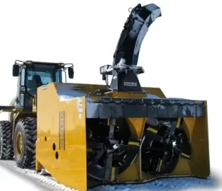

I have many hundreds of hours on this 8' beast.
Always lock the drive shaft before un-clogging the chute or replacing a shear pin. Always! :eek: :)

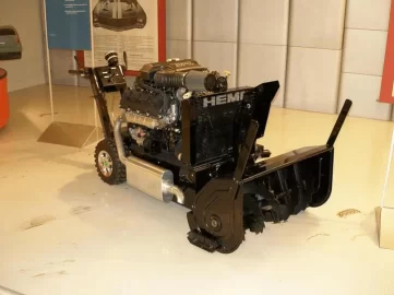

Personally I like this one best.::-)
  • [Hearth.com] Snow blower accident
First, nice machine! Second, why lock the driveshaft? Mine states I should disconnect the driveshaft from the PTO. Seems there's the potential for stored energy in a sprung and locked shaft, than in one disconnected and lying on the ground.
The augers would be out of ballance with snow & move as I shoveled snow out of it to replace the shear pin.
The auger with the sheared pin would move any way as you shoveled out the snow. 1 moving part is bad enough, 2 doubles the risks.
Then I'd spin the auger to align the shear pin holes & the drive shaft stayed put.
When the chute got plugged, that's a whole different game ;)
It was never dry, warm or sunny day work conditions. LOL ;lol
