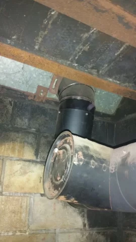

does this mean anything to you? Or do I need a camera down the chimney? I will have to call someone back out I suppose. [Hearth.com] so hawwttt!!!

Well for starters if you will be burning wood you need to get rid of that barometric damper. I would say the reason your chimney has no creosote is because the previous owner was burning coal. Which you need that barometric damper for and honestly your stove is better at than burning wood anyway. But looking at your setup I would say that pipe probably just sticks up into the smoke chamber which means it will make allot of creosote.
*gulp* Talk about putting a damper on things! (couldn't refrain) So at minimum, if I don't get a liner and I just fit it properly with whatever replacement damper you speak of- how much $ we talking?
Just a couple bucks for a new peice of pipe to replace the barometric damper. But Iwould not burn it like that if it was my house. Did they check for proper clearances to combustibles from the outside of the chimney structure?
Honestly I don't know anything about coal burning so I don't know if that's a normal set up for that. But bholler know his stuff. If it was me i wouldn't burn wood in it this year. If money's tight burn coal this year assuming you can get it and it's reasonably priced then next year or when finances allow put in a new efficient stove with proper liner

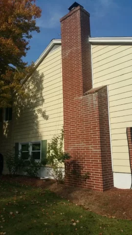

I guess? they didn't mention that as an issue. This is my chimney...I have no problem ripping out that rose bush out if i should. and I know I need a shoulder rebuild. That's coming next year. [Hearth.com] so hawwttt!!!
No I am talking about clearance to the combustibles in the house in your case you need 1" of clearance between the outside of that chimney and any combustible materials. If you don't have that you need an insulated liner to be safe in the event of a chimney fire.
