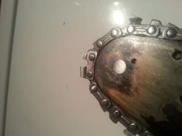

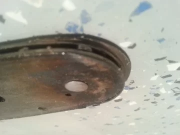

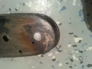

So, What happened to my bar?
Charles1981
Feb 19, 2013
762
Michigan
I am assuming the bar is ruined?
Not sure what happened other then I guess too much heat? I saw some smoke a few times going through some logs that were probably 25-26inch diameter that I had to attack from 2 different sides... I never let the bar oil go dry.
The lubrication system seems to be working just fine. I never really noticed any issues while sawing. I am assuming this happened over a 5-6 hour period while I was bucking about 4 cords of wood. The bar seems to be a little bowed as well.
Definitely going out to get a new bar. Just curious if anyone has seen this happen before.
Saw: Echo CS400 18inch

The nose sprocket bearing has gone to meet its maker.

That nose looks like it got very hot. Do you routinely lube it with a grease gun as you should? To me, the grease port looks empty in your pictures.
For 40 years I haven't greased the nose sprocket of any of my saws. The bar on the 65cc 1991 saw is the original bar with at least a hundred cord under is belt and it doesn't look tired yet. If the bar oiler is working right there is plenty of lube in the end of that bar.
greasing the nose sprocket is news to me.
I always check the bar oil spray after every tank/refill. Spray it against the butt end of a buck and make sure it is spraying a nice line of bar oil...
I will look into lubing the sprocket in the future though.
But overall I agree that the tip of the bar does appear to have overheated quite a bit.
Wow! That got hot enough th grease burned right out of it. If the tip is replaceable you can go that route, but a new bar is only $20 more.
Either never grease or always grease your choice but never do it "sometimes". On your next bar pick one or the other.
Whenever you flip the bar check how much play you have in the nose sprocket, if it moves more than a little you should replace the tip since the bearing is kaput.

OP, can you post a close-up picture of the chain you were running on this damaged bar?
I ALWAYS grease the nose of the bar, when I sharpen chain. That's what the small holes are for. Yes it does get some oil from the bar groove but why would manufacturer have the hole and recommend it be used?
Never seen a Stihl bar with the hole.
I saw it but figure the saw is just laying on its left side.
I thought I read you could grease a Sthil nose bearing. But recently I saw a Sthil video that they were saying it wasn't necessary. I never greased mine and 15 years it's OK. I think the key to bar life is a sharp chain all the time. And of course bar oil.
Where is the grease fitting?:p
Charles1981, was the saw cutting "circles" through the big log. If the kerfs are curved and the bar end picks up the previous cut it will put an S bend in the bar if you are working it hard.
Looks like it might be a laminated bar and one side took most of the friction.
