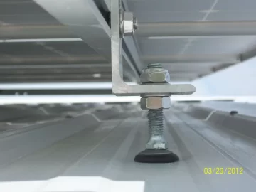

Something like that?
I don't remember offhand what manufacturer they are from.

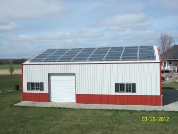

Cool! Is that yours?
I saw those on-line and it seems to want to be screwed into something substantial.
My metal roof is screwed into plywood decking, so I don't think it'd work.
What are those screwed into?
Yes, that is a picture from my array.
[Hearth.com] Solar Panels On Exposed Fastener Metal Roof
They are screwed (lagged) into 2x4's standing on edge under the metal roofing. The 2x4's are fastened to the roof trusses using hurricane brackets to make sure that the array cannot lift off of the roof.
Could you double up the plywood from underneath to be able to attach through?
Nice looking installation.
