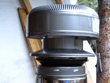

After ages of bouncing around different ideas of how to mate a deluxe raincap (twist on draft enhancing) to the standard Selkirk chimney (only option available a standard bolted clamp-on round top) I finally found a solution (being that the twist rings are about an inch different in diameter).
In my case, it was the JSC6ASE smoke pipe to chimney adapter (to go from 6 inch UT to 6 inch deluxe cap)
Maybe others have done it differently (my first thought was to find a female twist ring and attach it to the bottom of the rain cap, never really considered if using the next smaller sized cap would fit as I assumed that would require modification of the opening, plus I already had the 6 inch on hand), but if not, at least here is one work around. (in the picture the adapter is the black part, the lower portion slides inside the chimney and male threads are on top, only the double walled portion is exposed).

AKBear - long time no see! Looks like a neat solution, does it actually enhance draft or why did you get the different cap? How's the Deva doing?
It's not installed yet, but it was in my original plan and sitting around for years waiting. Now it waits for a tall ladder and well balanced person to change them out. As for the Deva, hopefully this winter I'll have a better opportunity to use it.

Rarely an issue here in the interior, but it wouldn't be a big deal to place a stainless band or a similar shield if that was a concern (I'm assuming you are referring to the black painted component being exposed rather than the male threads of the chimney pipe as those are exposed as well with the standard round cap albeit with a shorter vertical distance to the overhang of the cap)

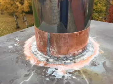

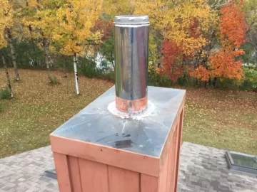

I just today finished the installation of 6" Selkirk Ultra-Temp chimney, and the crowning finish was installing the dinky cap that was supplied in my kit. Looks like it will come right off in the first real wind, I am not excited about it at all. will try and attach an image of the 6' pipe coming out of the copper cover on my wood chase/chimney which I just got converted today. (it did have B vent form a lpg gas fireplace coming through it before, so I took it today to the cooper guy down the road and he soldered on a collor for the 6') Anyway, I did not take a picture of the rain cap, but I think you all know it. And Yes , I expect I will install a storm colar of some sort. Any hint on what caulk/silicone, I can use to seal the copper collar to 6' joint as seen here in this image.
Thanks in advance for any thoughts.

HAve 'installed' the 6T-CT and tightened the bolt on the band that clamps down the three dinky tabs that hang over the pipe. Not alot of optimism there. However, anyone have any thoughts on what type of silicon/caulk I should use to caulk the seal between the copper collar and the 6' pipe as seen in the images I posted above? Also of course it rained hard last night, and I did get water down the pipe.
Thansk very much...
Personally I hate the 6T-CT. Right out of the box it was so flimsy that it was skewed and the mid-band out of round. Seems like it would take one raven to sit on top of it to squash the whole thing down (of course the ravens up here rival chickens for size). Furthermore, it's a draft constrictor rather than an enhancement and for anyone cleaning the chimney top down, quite a bit more involved to remove. (and at least from my viewpoint it really only partially covers the top threads of the chimney pipe, but living in an area where the majority of the people refuse to put any cap on a chimney so as not to have any restrictions or barriers, it's kind of a non-issue). I'm going to be much happier when that promised ladder finally shows up to get that eyesore off mine and replaced with the SPR6DRC.
I don't know what other's opinions on caulking would be, but I'm quite partial to the GE Household Glue (Silicone II) which comes in a small hand squeeze tube. From what I recall the temperature rating on it is 60 below to 400 above (best to double check the package of course) which ought to be more than adequate for practically any outdoor job without resorting to a special stove/engine ultra high temp sealant, plus it's a neutral sealant, which means it's not going to leach corrosive elements while curing (in other words, make sure it's the silicone II, not the silicone I)

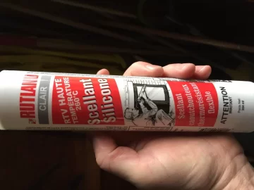

[Hearth.com] [SOLVED] Super/Pro deluxe raincap to Ultra/Sure Temp Going up on the roof later today with this, and a storm collar as well... Assuming this product can handle weather?
I can't find a low temp rating on it other than the application range (+30 to +100F). The high temp is +450 continuous and +500 intermittently and it's interior and exterior, so I can't imagine why it wouldn't be fine. And just like any other silicone products of that nature, let it fully cure before subjecting it to heat or flame (~24hrs).
Hi... thanks much, so then I will use it, and yes not planning to fire the woodstove yet, but we are expecting rain for the rest of the week starting sometime tomorrow, so I want to seal that joint between copper collar and Selkirk and also get the storm collar in place and sealed to the Selkirk by tonight so that the rain tomorrow (and rest of the week) is not running town the pipe into the house.
