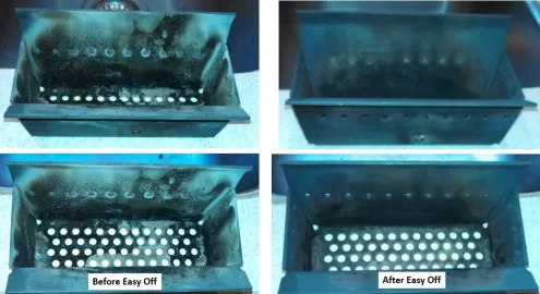

Tried the EasyOff. Pot was pretty clean but I tried it any way.
Results below:
Watch out - These things have sharp edges and I cut my fingers!
Still needed mechanical scraping - but I did not wait as long as I should have.....
