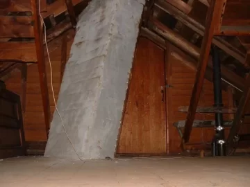

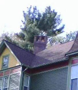

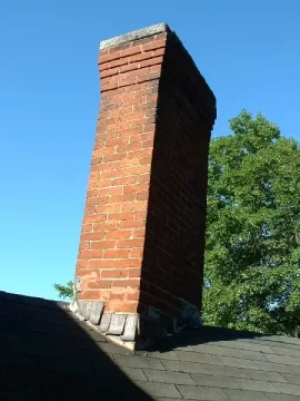

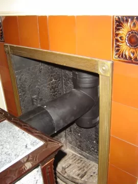

OK I should have posted these in the original send... Here are pix of the original chimney (prior to any repairs), a blurry view showing the cap we had built, a view showing the chimney inside the attic, and a view of the single wall pipe & tee behind the stove as they look today.
Possibly in that order.
Hope this helps clarify things. :)
