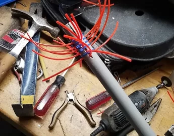

I made my own. I had a bunch of 1" grey underground PVC around from another project. I made one 10' and another 5'. I'll clean it from the top.
I couldn't see spending $50 on a few kits when I could make it in 15 mins.
That's beautiful. I like the juxtaposition of bright colors on the bland grey pipe. ;)
Do the zip ties just pinch the line in that groove?
