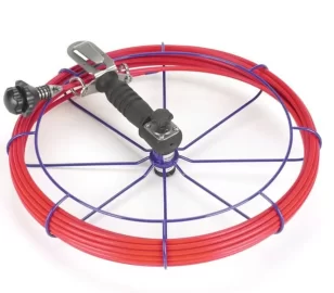

I'm thinking about spending the big bucks for one of these Vipers, especially since I added a second stove with a 25 foot flue.

My guess is that you don't have a 12/12 pitch metal roof, with a chimney that extends 8 feet above it, so you'd need to put a ladder on the 12/12 slope...just a guess.
Ouch - with a setup like that I'd go nuts. It would be worth the $$ for the Viper.

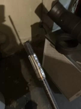

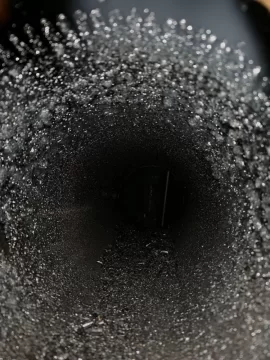

Mine busted the first time I used it!

Can you tell us more about the failure mode? was the drill spinning on the fastes setting and how many extensions were you spinning?
Sure... Corded drill connected to 4 extension rods, did not have the drill spinning at the fastest setting, would say half speed. Snapped right at the bend for the tee snout.
Prior to the rod snapping, system was working smooth. Appeared to do a good job.
ok so you were making a 90 degree turn. I know lots of users do that so you must have just been unlucky.
Works great on my BK through the bypass but the angle is like 60 - 70 degrees. I would not want to try a real 90 with then while spinning at high speed.
What size pipe was it in?
Are they actually designed to make a 90? Don't believe I'd be comfy trying a 90 with mine! It just doesn't strike me as 90 friendly? To stiff.

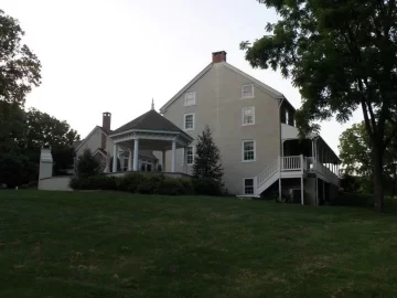

Define “simple”. Here’s my chimney, and that’s a 12/12 pitch raised-seam metal roof:
[Hearth.com] Soot Eater - Yay or Nay?
My 40 foot ladder does not even reach the top of the chimney, the only access is to put a 28 foot ladder to the soffit, then scurry up a chicken to the peak, and try to straddle the peak while removing that flagstone topper to insert a brush.
Any volunteers? I think I’ll just stick with the soot eater, up thru the bypass door. [emoji38]
It's not the 90 degrees that kills you. It's the bend radius you use to get that 90 degrees. I do not think you could shove a sooteater through a 90 degree tee or 90 degree bend in a 6" pipe but you can go into the door of a stove and up through a top exhaust just fine which is also 90 degrees but a much larger bend radius.
I've snapped one rod while trying to push the sooteater through the stove and up the chimney from across the room with like 4 rods attached, I was getting lazy. Pushing towards the stove bent the rod too sharply and it snapped.
