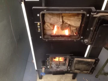

As promised in post #24. I would guess i have burned about 14 cords since i put up the sheetrock. This is a pic during a burn, with the primary door open (and secondary but the window is still there), without using the bypass. Really i only use the bypass when starting a fire IF there is no cold coals left from the previous burn. If there is coals i toss in a handful of noodles with a match and load up.

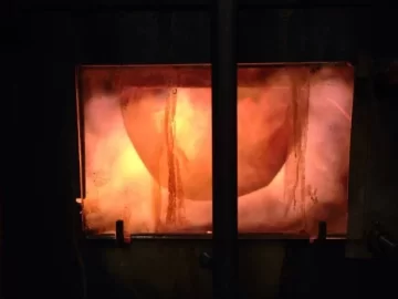

Coal Reaper, do you ever get any creosote on your window? I get the odd dribble that runs down from the firebox, doesn't happen very often but kind of interferes with the view of the fire when it does.
Eko is positive pressure. Varms and some others dont even have door seals to worry about.
@maple1 , Yes some creosote dribble when i burn wood that is not dry all the way. if i have wood that i know is less than optimal (usually oak) i will put it in last on top of other <20%MC stuff.
one time i was burning a full load of chunks that werent quite dry. one chunk musta fallen and completely covered the nozzle. no air flow, temp dropped, fan shut off, wood continued to cook/boil. that made a huge dribble. a puddle even. lets not talk about that.

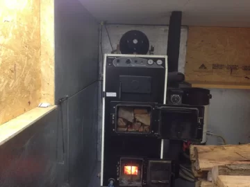

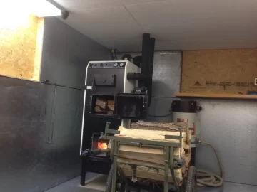

Many problems that I don't seem to have with my 25!

Fred, what kind of controller is that on your 25? I've never seen one like that before.
It's called Eccoster2. I suspect it is mostly used in Europe since it registers in centigrade and the highest setpoint is 80C (180F) I don't use most of the features since I control my pump launch with a Tekmar 156. For me It's basically an on/off switch and high temp control.
