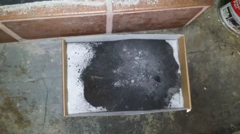

I cleaned the chimney today. I was impressed at how easy it was to operate. I got a lot of soot out of it. See picture.
Were you able to get the black rods to make a 90-degree turn in a 6" flue without breaking? If so, amazing!
Yes I was I just took my time.... it took me 2 hours to get the job done and I did it at a very slow speed
