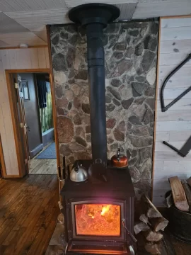

Will a sooteater go up through my stove and 2 45s ?I'm getting too scared to go on metal roof anymore.

As above. Fine.
I go through a 90 T where my horizontal section enters the flue liner.
I’ve gone through a 90 with one. Black rods. I hear there are white ones now also.
We have a pair of 45s in an offset. The sooteater barely notices them.
pair of45no problem

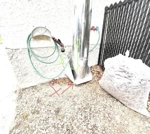

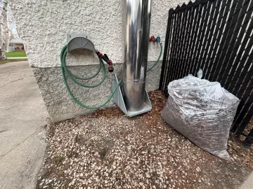

So to do my friend's chimney with a sooteater can I get into the bottom of this chimney if I dig down?

From your photo, it appears to me that bracket supports a 90. It doesn’t look lIke there is any access other than from the top or the inside before the 90. But, the soot eater should be able to make it past that 90 from the bottom and work towards the top.
